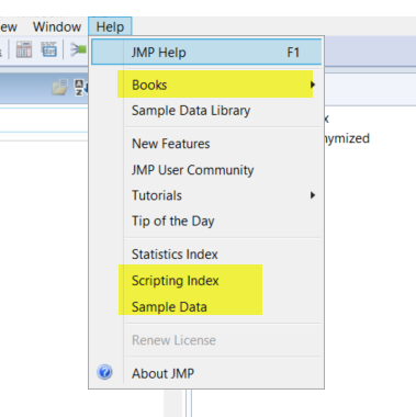

      Also, the following are really useful resources that you have at your disposal, that you should try and start exploring:
1. Scripting Index
2. Sample Data
3. Books
