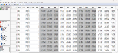

I work with relatively big tables, like 1000+ rows. I should probably figure out databases at some point, but for now, JMP tables are what I'm doing. Because of this, I have groups of columns that are placed adjacent to each other. When scrolling through, sometimes I can't keep everything in my head, and having visually present spacers would be extremely helpful from a sanity point of view. Does JMP have anything like this? A few google searches didn't turn anything up, but maybe I'm missing something. Right now, I just make a really narrow colored column with a period in the top, which works, but just wondering if JMP had come up with a smarter way to do it. I've attached an image of what I usually do.

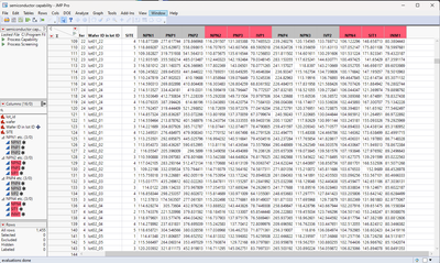

In JMP 18 you can color the column header background.  This might give you what you need.  Also grouping the columns in the columns panel.
In earlier releases and in release 18, you can always color the background color of the cells.  This example is from JMP 15
