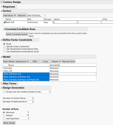

If you want to create it more easily (and automatically), you can use the Custom Design platform, specify one continuous factor ("ratio A:B", range from 0 to 1), and specify a model containing main effect and higher order terms (up to the 4th order if you want to generate 5 experiments for example) :
Once you have generated this simple design you can fill the response(s) and a script "Fit Model" will enable you to fit the polynomial model on the response(s) you have assumed during design creation.
Please find attached the datatable generated.
