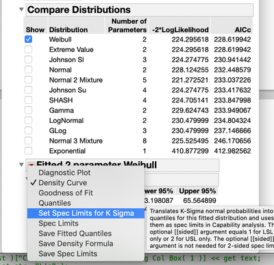

My problem occurs when I want to use the "Set Spec Limits for K Sigma" command.  Naturally I must indicate which one of the specific fits this is meant for.  I've tried using Fit HandleI[1], intending to refer to the first fit in the "Compare Distributions" table, but this has no effect.
In the example above, I can use Set Spec Limits for K Sigma command in the GUI (i.e. report window), so in theory I believe I should be able to do this programmatically as well.  So far the best option I can think of is to use the above code to identify the best distribution, the re-perform a separate fit using that specific distrubtion, which I would then be able to refer the Set Spec Limits for K Sigma command to.  This involves extra computation and code though, which I would prefer to avoid.

In the GUI, one can click on the red down arrow next to the distribution and select "Set Spec Limits...", as shown below.  Do you suppose there's a way to tell JSL to "click" on the RDA and select the 5th item in the resulting dropdown list?  That is, rather than figure out the commands to do this, just have JSL hijack the GUI.  Is anything like that possible?
