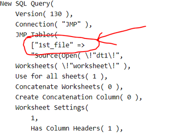

Hi @stan_koprowski ,
I appreciate your help. The script will only run if the following file name matches
Updating Media
What if I want to run the same script on different files ? Let's my 2nd file name remains constant and I want to perform similar operations on different files. I have multiple excel file with different name(All files have same columns)
Any suggestions?
