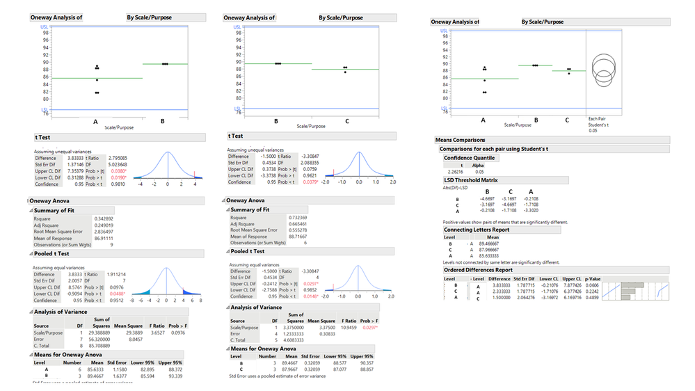

I am comparing the means of three (small) samples. I have three groups (A, B, C). If I compare them in two steps (A with B, B with C) I get significant mean difference according to t-test and pooled t test.
However, if I run a comparison on A, B and C at the same time, using "Each pair Student's t" , I get no significant difference.
(Example is provided as a picture).
Could someone please help me understand the theory behind the difference in the results ?

  • Homogeneity of variance may also not be respected (in your example, group B seems to have no variance, group C a very small variance and group A more variance). To check this, you can test "Unequal Variance" in the red triangle of the "Fit Y by X" platform. JMP will also provide you Welch's test, a modified t-test not assuming equal variances between your 2 groups, which may be informative for some of the comparisons you're doing.
  • If you want to compare more than two groups, t-test shouldn't be used, but Tukey-Kramer (in case of parametric test, to limit type I error) or Steel-Dwass (non parametric version). There are a lot of statistical tests available, take time to see which one is the best fit to your problem, in terms of goals and assumptions met.
Also take a look at confidence interval, you'll see in your comparisons that you have overlap of your Confidence Intervals, which may indicate that you don't have a large effect size and/or a real statistical difference. Due to the low sample size and assumptions not met for a parametric test like t-test, the significant results may be only type I errors (mistaken rejections of an actually true null hypothesis, the true null hypothesis being here that the groups means are the same/equivalent).

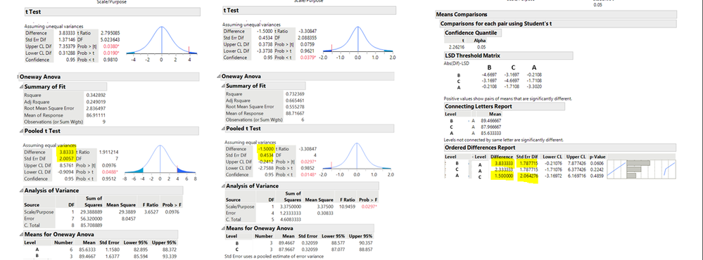

I suspect the assumptions are different. Seems that you have masked the Level names, and I am not sure whether there is any errors that you made during the masking. I am going to highlight 4 numbers in your screenshots, and I hope they are corresponding to one another (e.g. on the surface second ANOVA shows -1.5 between B/C, and there is a 1.5 in LSD, but it appears to be A/C, so I am not sure).
I want to point out that the values of differences are same, but Standard Errors of the differences are different. In ANOVA, there are notes: Assuming equal variances. In LSD comparisons, I don't see explicit statement about equal or unequal variances assumptions in documentation, but I believe the assumption is unequal variances. And the detail of calculating Standard Error can be found on this page Comparison Circles
