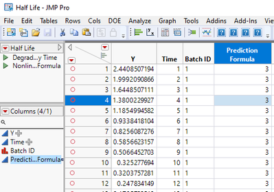

The attached table shows how to fit Model A using Nonlinear and Degradation. Data is simulated.

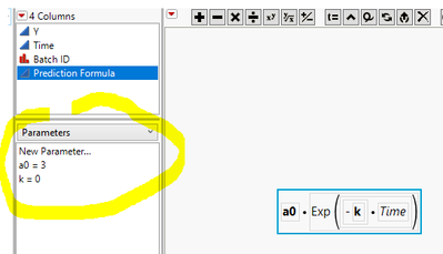

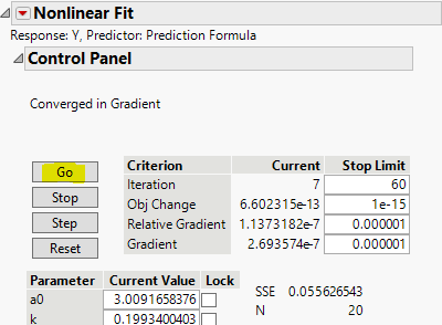

To use Nonlinear, you need to create a prediction formula column, like the last one in the table. The formula is a Parameter JSL function:
Read Example of the Nonlinear Platform to see how to create such a formula step by step.

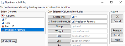

Then you configure the launch dialog like this, then click OK.
Click Go button in the report, then you get the result.

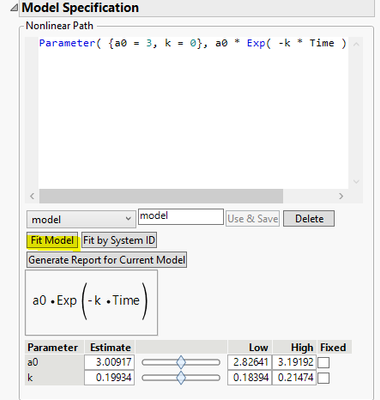

To use Degradation, you need to create a dummy ID column, filled with the same value. I am assuming that you only have one trace of concentration readings.
Configure the launch dialog like this, then hit OK.
From the report menu, choose "Nonlinear Path" under "Degradation Path Style".

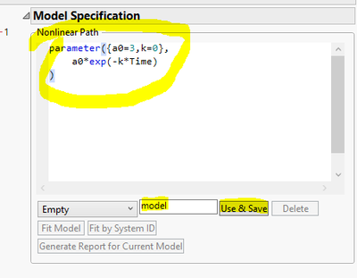

Fill in the prediction formula as a piece of JSL, give it a name (I call it "model"), click "Use & Save". What you entered is technically the same as what you entered to create the last prediction column used in Nonlinear. As you learn more, you should recognize what in the curly brackets are parameters and their initial values. followed by the definition of your formula, and both of them are wrapped around inside of a Parameter call.
Then click "Fit Model".
If your model does not fit, try to tweak the initial values, then click "Use & Save", followed by "Fit Model".
Finally, click "Generate Report for Current Model" to produce the final report.

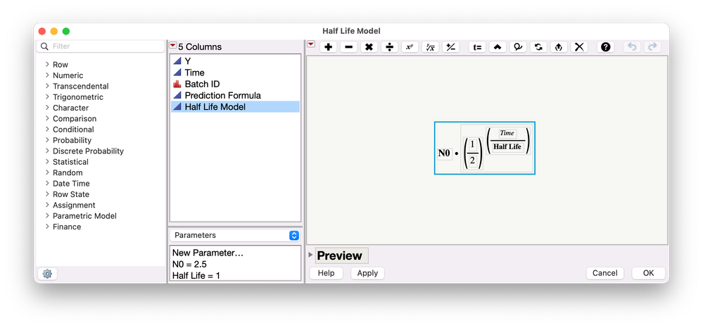

I wonder if using the original parameterization would help the interpretation. Specifically the direct estimation of the half life. I used this formula for the non-linear model:

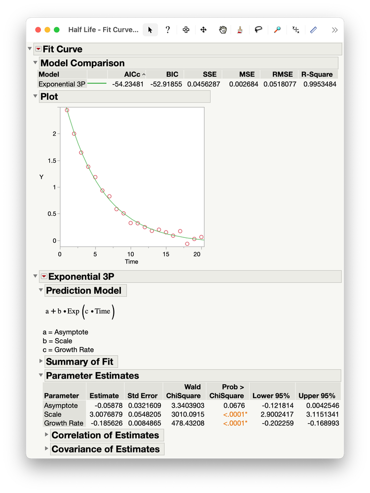

I obtained this fit:
@peng_liu's solution is also available as one of the models available in Fit Curve.
So you have a lot of flexibility in how you model your data.
