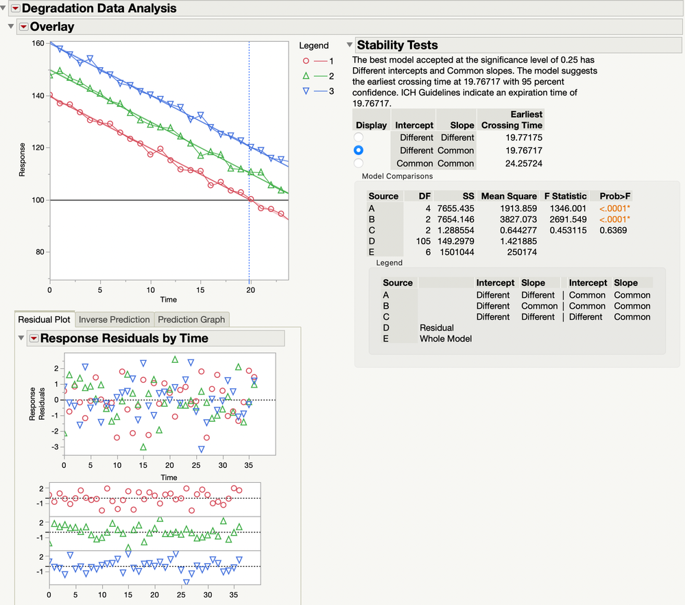

In attached I have plotted the behaviour of 3 batch. In the plot is presented the variable of interesting vs time. Each batch one have different slope.

The plot you showed looks like Graph Builder. Am I correct? The Stability Test in the Degradation platform will help you determine if you can pool the batches or not, and if not, which lot to use. The decision about pooling and the model is yours based on the default alpha = 0.25 or an alternative alpha that you determine.

Yes, it is Graph Builder.
As you suggested I performed the Degradation test.

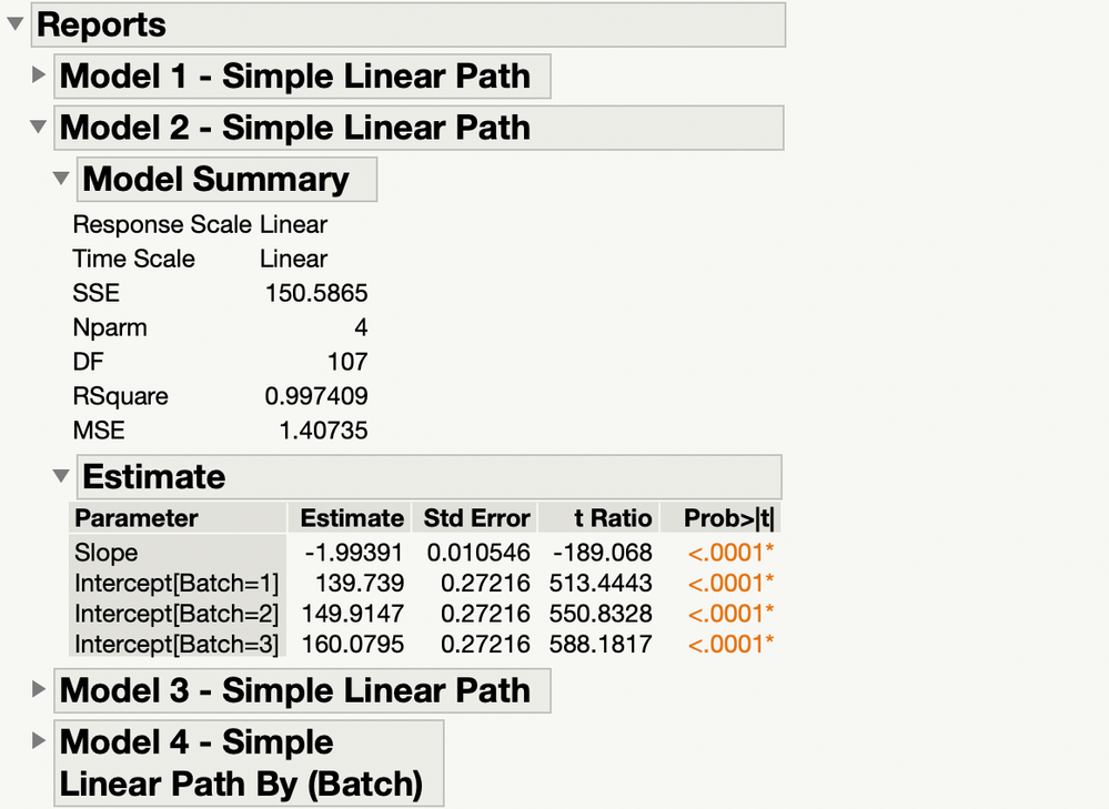

According with the alpha, i have on 3 batches different intercept and common slope, AS guidelines suggest.
Please, How I can put out the equation from this platform?
Re: Determination of product specs by Stability Results
I mocked up your case of different intercepts but a common slope across 3 batches. I selected Analyze > Reliability > Degradation. I selected the Stability Test tab and entered Response, Time, and Batch into their respective analysis roles. I saved a script to the data table for this set up. I find the following results that should appear similar to your results:

The second model is selected automatically using the default α = 0.25 for statistical significance. So the relevant information is found in the Model 2 - Simple Linear Path under the Reports outline:
Your case is one in which the response is decreasing over time, so the batch with lowest intercept will cross the lower specification first. So the equation is response = 139.739 - 1.99391*Time.
