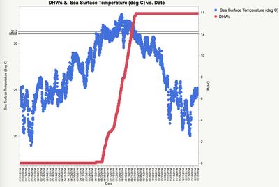

I think a figure may better explain what I want to do:
so the red line represents the degree-heating weeks. Instead of plateauing, it should basically drop back to zero as temperatures fall (blue). But for the life of me, I can't think of how to script this!

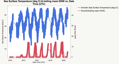

But that I really want to do is basically suppress the DHW calculation at time in which no heat is accumulating (i.e., the plateau phase).
Screen Shot 2020-08-10 at 19.05.18.pngBasically, I told JMP to only calculate the DHW when temperatures were above 29 because I want the DHW to fall back to 0 once the temperature has dropped. Is it possible to define "year" in the moving average formula? In that case, I could plot DHW over month for each of the year. If I don't do that, the DHW will keep accumulating from one year to the next!

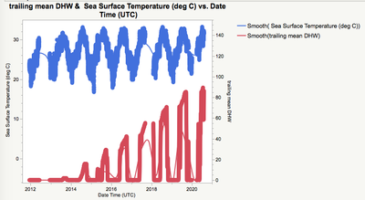

I think I kind of got what I wanted by playing around with the formulas. Basically, I suppressed the calculation of the DHW under 28C (since nothing interesting is happening then) and then did a trailing mean DHW over the preceding 90 days since eventually the DHW will fall to 0 once the temperature hits 28. This then means the trailing mean DHW eventually tapers off. Then, the plot effectively resets from year to year. It's kind of cheating, but in the end, it gave me what I wanted! Still, I am open to suggestions if people can think of a better, more objective way to do this that doesn't require so much arbitrary binning and tweaking.
