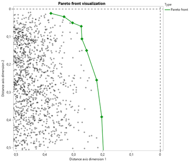

For this reason, I tend to prefer using Pareto front to detect optimal solutions/formulations based on different emphasis between responses/properties. There is no dedicated JMP platform, but there may be several options to do this:
  • You can create a large candidate dataset thanks to the models fitted to the responses using the Simulator (Simulation Experiment) or by creating a large space filling design and adding the responses formula to your table. Then, you can Select Rows in Data Tables and choose the option Select Dominant . The resultant set of rows is called the Pareto Frontier.

  • You can also do the previous options but instead of using directly the responses, you can use the normalized euclidian distances to avoid that a response may have a too strong influence on the others, and check the correlations between the responses distances to optimum. If you can reduce the dimensionality, the visualization is again greatly facilitated:
Hope this other approach and few tricks may help you,
