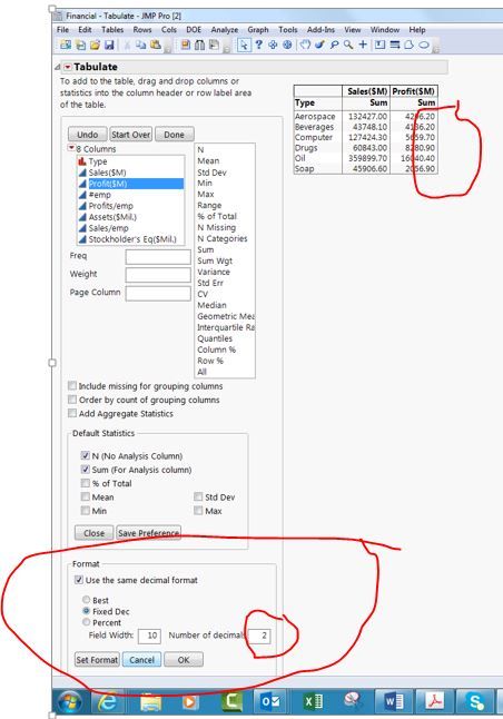

Here i want to set 2 decimal place in tabulate. But i can not find where to set in JMP. Can you help me?
GMan

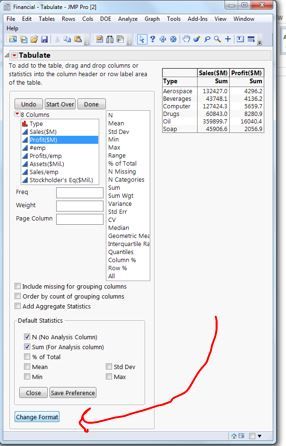

Re: Decimal places in tabulate
You should see a 'Change Format' button. Ptressing this should give you the options you need.
Screen Shot 2017-11-20 at 08.59.17.pngScreen Shot 2017-11-20 at 08.59.17.png

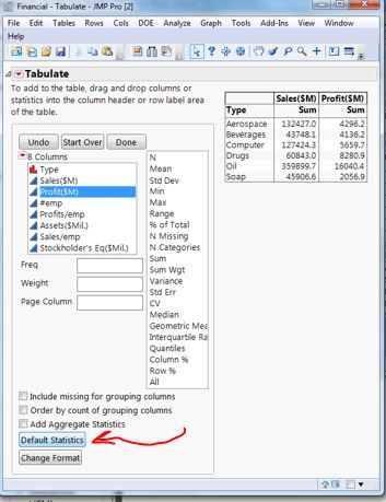

Yes, First Default Statistics, then CHANGE FORMAT, then SET FORMAT.
First Default Statistics.JPGFirst Default Statistics.JPGSecond Change Format.JPGSecond Change Format.JPGThird Set Fomat.JPGThird Set Fomat.JPG
