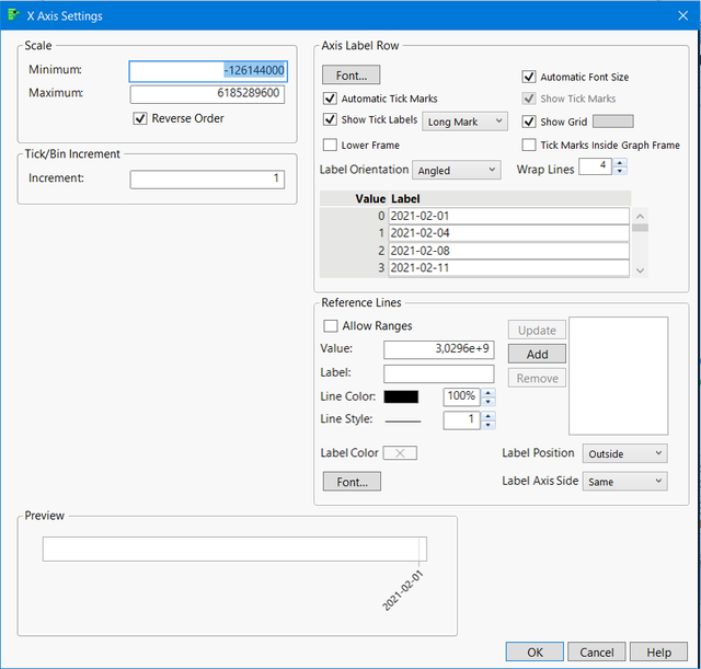

Hi,
With the upgrade to JMP 18 we broke a script that displays results over time.
It seems I'm not able to tell the graph builder that the x-axis are dates.  The column is formatted as date (yyyy-mm-dd).  When I import the dates into the graph, all dates get a value and are displayed based on that value.  However, this results in an incorrect graph:
2025-02-01 - Value 0
2025-02-02 - Value 1
2025-03-01 - Value 2
There will be just as much space between all values, but there is a big difference of days between those dates!
Also, we did set the increments to a week.  How would I do this in the case above?  We also would like to have the thick starting on the same day (eg monday) for each chart.
Is there a way to do this in JMP 18?
jan_solo_ff
Level II
Re: Dates on an X-axis for graph builder
I cant put the data here, company policy.  However, I was able to figure it out with your reply.
Once I changed the modeling type to 'Continuous', I could work with dates again.
Thank you!

jthi
Can you provide example data? Are your dates properly formatted as dates (numeric and not character)? What is the modelling type?
-Jarmo
jan_solo_ff
Level II
Thank you!
