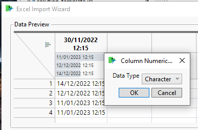

I have imported the following data from excel to JMP on several different computers using the same script
30/11/2022 12:15
14/12/2022 12:15
12/12/2022 12:15
11/01/2023 12:15
11/01/2023 12:15
On some computers, JMP gives the following:
30.11.2022 12:15
14.12.2022 12:15
12.12.2022 12:15
11.01.2023 12:15
11.01.2023 12:15
While others produce this results:
44895,5104166667
44909,5104166667
44907,5104166667
44937,5104166667
44937,5104166667
And I am not able to convert these numbers back to the correct dates in JMP. Any idea why this is happening and what to do to avoid it?

If I had to guess the different computers are using different date (or time) settings (either in JMP and/or Windows). If you are able to load those dates as characters, you might be able to fix them before they break
Or something this might or might not work
excel_datetime = 44895.5104166667;
As date(In Days(excel_datetime) + Date DMY(30, 12, 1899));

jthi
Re: Date import from excel
DATEVALUE function (support.microsoft.com)
Excel stores dates as sequential serial numbers so that they can be used in calculations. By default, January 1, 1900 is serial number 1, and January 1, 2008 is serial number 39448 because it is 39,447 days after January 1, 1900.
Excel also has a nice feature where it assumes that 1900 is a leap year which might affect your calculations if you try to perform the conversion by hand Excel incorrectly assumes that the year 1900 is a leap year
-Jarmo
Steffen_Bugge
Level IV
Thanks @jthi! Spot on!
