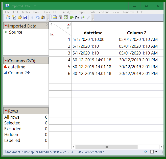

I have a set of data where I have a couple different formats for dates and I am creating a new column to convert the dates to one format.  The dates are in d/m/y h:m:s format.  When I run the script all of the 2019 dates translate fine, but the 2020 dates get their month day reversed.  If I go into column information and change the settings manually it works fine.  What can I do within JSL to retain the correct format?
DateTime
5/1/2020 1:10
5/1/2020 1:10
5/1/2020 1:10
30-12-2019 14:01:18
30-12-2019 14:01:18
30-12-2019 14:01:18
New Column("DateTime2",numeric,"Continuous",format("d/m/y h:m:s",22,0),input format("d/m/y h:m:s",0));
for each row( :DateTime2 = num(:DateTime));
DateTime DateTime2
5/1/2020 1:10 01/05/2020 1:10:00 AM
30-12-2019 14:01:18 30/12/2019 2:01:18 PM

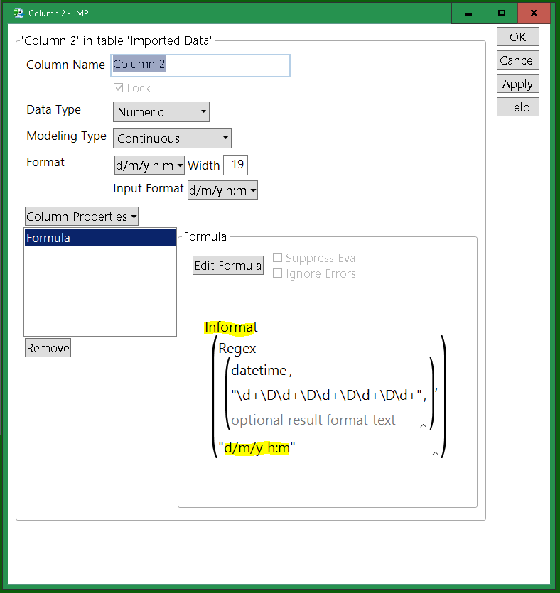

Your input date is character data, and you are using the num() function to guess the date's format. Use the informat function and specify the format. Some of your data has seconds and some doesn't. You can use regex to keep everything up to where the seconds might be. \d+ matches one or more digits and \D matches non-digit.
Informat( Regex( :datetime, "\d+\D\d+\D\d+\D\d+\D\d+" ), "d/m/y h:m" )
JMP guesses m/d/y for ambiguous dates; the example dates you have for 2019 are not ambiguous.
the datetime column is character data, column2 is a formula columnthe datetime column is character data, column2 is a formula column
Column 2 formulaColumn 2 formula
