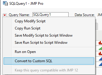

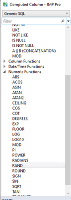

Hi,
when I generate a Database Query via the GUI in Jmp, how can I use advanced SQL functionality?
  • SQL formulas (rand (),txt = Substring(), myValue = a+b )
  • Explode
  • Lateral View
jthi
Re: Database access
Most likely JMP's SQL GUI doesn't support all possible SQL commands and functions which are available depending on which SQL is being used but you could convert the query to Custom SQL and add those yourself
or something is maybe found from computed columns

jthi
Re: Database access
-Jarmo
hogi
Level XIII
Re: Database access
red triangle -> hidden wonderland.
concerning
  • Explode
  • Lateral View
... maybe a developer will find this post and consider implementing it in a future release ...
