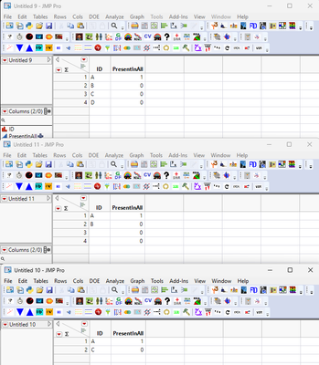

I want to compare more than 2 tables in JMP for a common column present in all the tables. Now i want to return a 1 if the values in that specific column exists in each table otherwise 0. This im able to do for some predefined tables and by using a JSL script which adds an extra column in each table and return 0 or 1.
But i want to make this script generic so that i dont need to predefine the name of tables. It should be like, whenever i run this script, it should ask me which tables i want to compare.
After that, i also want this script to work in such a way it can also give me the option to select which column i want to compare
Currently, Im using this script

Selecting three tables Untitled 9, Untitled 10 and Untitled 11 and the column im comparing is "ID"

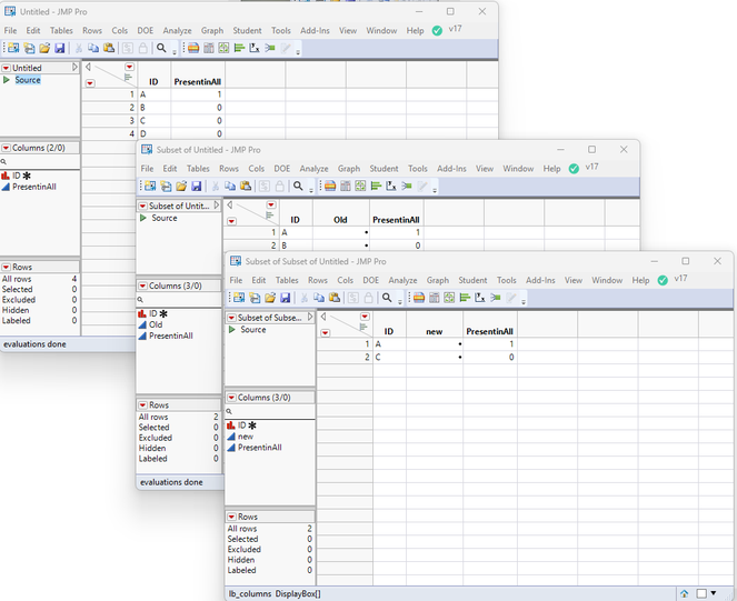

Here is a fleshed out piece of JSL that takes Jarmo's JSL and expands on it to give you the results you show in your initial discussion.
It uses Associative arrays to find the intersection of both the column names that appear in all 3 tables, and then also in the values that appear in the selected column.
It also uses the Update Platform to move the results back into the original 3 tables.  The methodology should be pretty efficient even on very large data tables.
