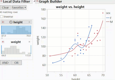

To generate a dashboard with a filter beyond the current data range, I generated a GraphBuilder plot with lower spec = 1 via
Graph Builder(
	Variables( X( :height ), Y( :weight ), Overlay( :sex ) ),
	Elements( Points( X, Y, Legend( 1 ) ), Smoother( X, Y, Legend( 2 ) ) ),
	Local Data Filter(
		Conditional,
		Add Filter( columns( :height ), Where( :height >= 1 ) )
the result didn't look promising:

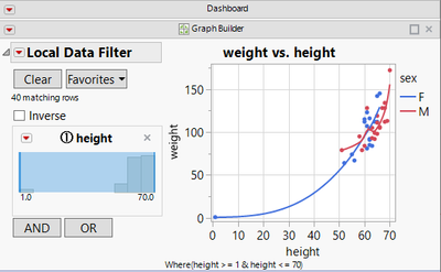

then I added it to a Dashboard

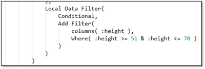

and checked the code - and indeed - Jmp did adjust my spec:
I set the limit back to 1 and used the code to generate a new dashboard, checked the code again and it was again 51.
