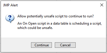

hogi
Level XIII
Re: Data Table On Close Issue depending on how it is closed
It seems that the onClose option doesn't get saved with the data table.
Is there  a possibility to store the onClose setting with the data table?
If not, is there a possibility to execute the OnClose message lisently when the data table is opened by the user?
I tried to put
dt << on close(	Function( {a}, Close( (a << child) << getdatatable, nosave );	1;));
into my On Open Table Script, but now whenever I open the data table, Jmp shows the warning:
Hm, scheduling a script
- big words for "tell Jmp at the end to do nothing, not even save the data" ;)
