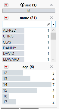

I just noticed that if the data filter is set to "conditional", it is not possible to add a new filter group.
You can still use the code, but the action is exactly like in the first case: new filter is included in the first filter.
This means that it is not possible to define 2 distinct filter groups with conditional behavior.

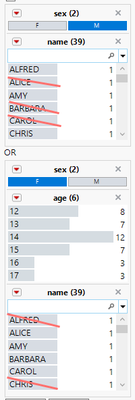

gb = dt << Graph Builder(
	Graph Spacing( 5 ),
	Variables,
	Elements( Points( Legend( 2 ) ) ),
df = gb << 	Local Data Filter(
		Add Filter( columns( :sex, :name ),Where(:sex="M"),Display( :name, N Items( 6 ))),
		Add Filter( columns( :sex, :age, :name ),Where(:sex="F"), Display( :name, N Items( 6 )))
wait(5);
// 2 separate data filters --> OR
gb <<Remove Local Data Filter;
wait(1);
		Conditional,
// 2nd data filter is included in the first one

I still need some further input to understand why it's not possible to add a second data filter group to the data filter if "conditional" is enabled.
For the second example above, I expected to get two data filter groups, one for male (with just male names) and one for female (with just female names) -
actually like it's the case when "conditional" is not activated, just with the feature that the male/female selection restricts the list of names.
I mean: conditional should just activate the conditional displaying of list entries - it should not change the logics behind the data filter structure.
It's surprising that the result for the second example with "conditional" activated is so different:
  • no second data filter group
  • :sex=F and the list for :name from the second data filter group don't show up (seems that they are merged into the first data filter group and don't show up twice)
  • indication why it seems to be like this:
    :age from the second data filter is added to the first data filter group
what I expected:
what I got:
