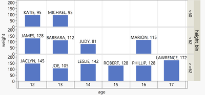

according to this table, it's James, Barbara, Judy and Marion.
If you want to define the the height_bins via a Data Filter, make sure that you don't miss the junction points, e.g. height=60.
