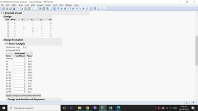

I have four continuous factors. I want to optimized the process that's why I clicked add blocks  with center runs to estimate quadratic effects.

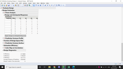

I click the script "Evaluate of Design" after making the table. I clicked RSM. The values of 2FI and Quadratic in Power Analysis are small. I also noticed that there is no quadratic term for my 4th factor.

First of all, let's remind that definitive screening design is a screening design, so its aim is to detect significant main effects from a list of factors (although it is also capable of fitting some interactions and quadratic effects if remaining degrees of freedom allow it).
So in this sense, it's normal to have lower power for interactions and quadratic effects than for main effects, since the main effects in this design are not aliased with any 2-factors or quadratic effects. On the opposite, some aliases are still present between 2-factors interactions and quadratics effects (see correlation plot done on your example with 4 factors), so detecting precisely the significance for QE and 2FI will be more difficult with the presence of aliases (hence a lower power).
DSD is more recommended for 5+ factors; for less than 5 factors it may be easier and more efficient in terms of experiments number to use Custom Design.
Since it's a screenign design, its aim is not to fit a full RSM model (and JMP should have warned you when clicking on RSM that "This design cannot fit the specified model. Inestimable model terms have been removed"), so that's why you don't see quadratic effect for your 4th factor (lack of degree of freedom to precisely calculate this effect estimate).
