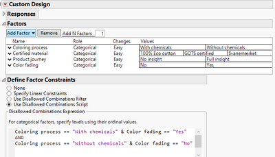

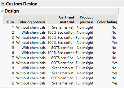

In addition to @ih's suggestion, I wonder if you are setting up an impossible design given the model you specified. It seems like Coloring Process and Color Fading are confounded.
