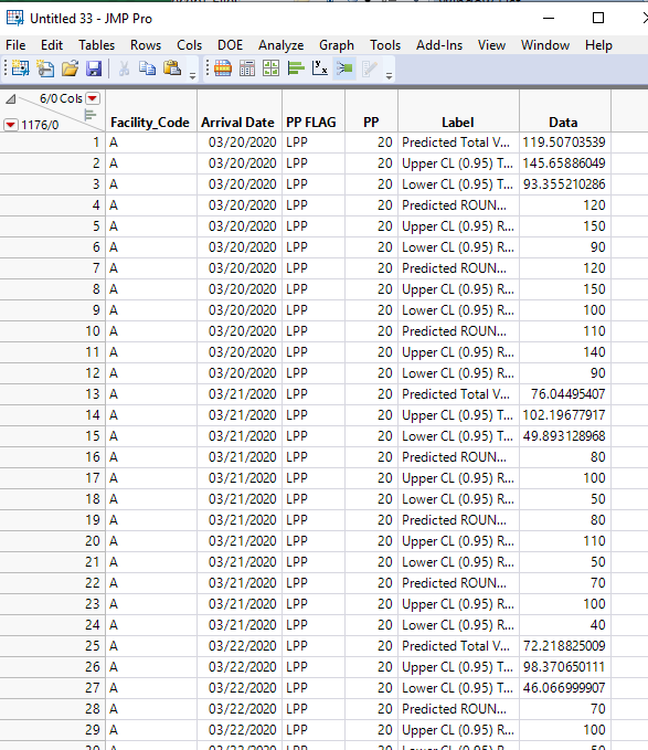

I have data in wide format  i.e col  with  three variables: predicted, upper and lower and respective rounding options like round up of predicted, upper and lower, round down of predicted, upper and lower etc. which I want to  reorganize it in long format i.e  some constant rows like date and all of the value has to be reformatted into longer.
I have attached the " have" and "want" data.

Go to
    Tables==>Stack
and stack all of your predicted columns, and you will have what you want stack.PNG
