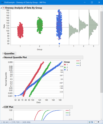

Have you explored Fit Y by X for continuous Y and Nominal X? It creates a view with histograms and CDF plots and normal quantile plots. I have attached an example table with two attached scripts:
  1. to create a table with custom quantiles (the column names coudl be cleaned up) using table Summary
  2. the other to demonstrate the Fit Y by X platform
Note the axis increments control the bin size of the histograms for this platform and Distribution. You can Right click and select Axis settings and change the axis increments. Right click again and save to the column property then all subsequent graphs will use the same unit. Or you can right click and select Edit > Copy Axis Settings, then hold teh control key and right click >Edit>Paste Axis Settings an all histograms will have the same scaling/binning.
I hope this gets you closer to what you need.
