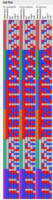

Here is how the final design looks like with a Cell plot visualization and a Parallel plot (unrandomized, just sorted by Whole Plots to better understand the pattern repetition accross species and Whole Plots):
Please find attached the design proposed with all scripts (visualizations, models, and randomized version of the DOE).

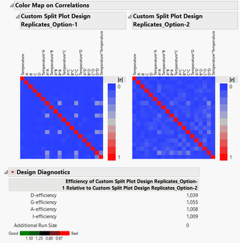

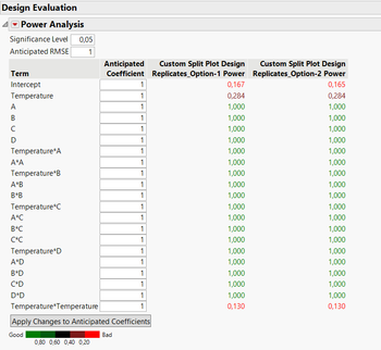

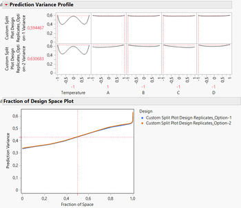

The comparison of the two designs performance shows similar results:
  • Power analysis:
  • Prediction variance and FDS:
  • Correlation map and design diagnostics:

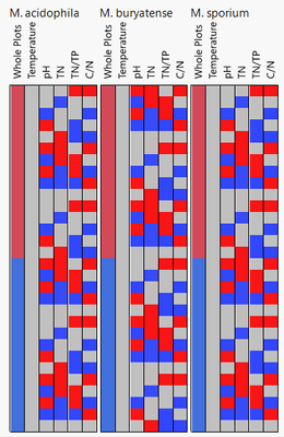

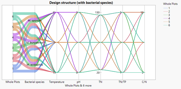

Ok, I think I understand what you want to design.
In fact, the three replicates are each allocated to one bacterial species, and that's why you want the runs to be triplicated in each whole plot, to make the visualization and comparison easier.
So using the design option 2 shared before, I have added a column for bacterial species in order to identify the "triplicates" so that each run is allocated to one different species. If you want to create the design from scratch, you can follow the process of design option 2, but keep the replicate runs identification to save some time at the end and be able to attribute the replicates to each species.
I have modified the model script (to analyze by species) and some visualizations, this design should now meet your requirements ?
Let me know if I missed something,
