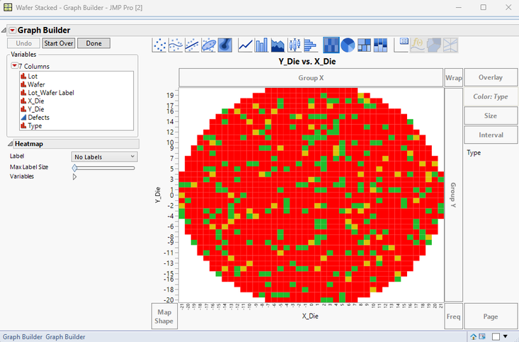

txnelson
Re: Creating a wafer map with discrete cell values
It appears that JMP 14 forces the colors to a gradient.  Therefore, I ran the wafermap and then created a custom gradient pattern, where only 3 colors were defined for the gradient.  The code below was generated in JMP 14
Names Default To Here( 1 );
dt = Open( "$SAMPLE_DATA/Wafer Stacked.jmp" );
dt:X_Die << Set Modeling Type( "Nominal" );
dt:Y_Die << Set Modeling Type( "Nominal" );
dt << Delete Rows( dt << Get Rows Where( :Lot_Wafer Label != "1_1" ) );
dt << New Column( "Type",
	Numeric,
	"Nominal",
	<<Set Each Value( Random Category( 0.15, 1, 0.05, 2, 0.8, 3 ) )
gb = Graph Builder(
	Variables( X( :X_Die ), Y( :Y_Die ), Color( :Type ) ),
	Elements( Heatmap( X, Y, Legend( 5 ) ) ),
	SendToReport(
		Dispatch(
			"400",
			ScaleBox,
			{Legend Model(
				5,
				Properties(
					0,
					{gradient(
						{Color Theme(
							{"Green Yellow Red Copy", 1, {"Green", {110, 197, 30}, "Yellow", {224, 176, 10},
							"red", {256, 0, 0}}}
						Item ID( "Type", 1 )
		Dispatch( {}, "400", LegendBox, {Legend Position( {5, [-1]} ), Position( {-1} )} )

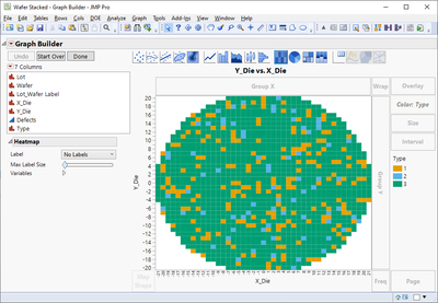

jthi
This might behave differently in JMP14 than in JMP17, but make sure that Summary statistic is set to None
Also if you have multiple wafermaps in same plot, how should JMP determine which category to use if same coordinate has multiple different categories?
This is done with JMP17
Names Default To Here(1);
dt = Open("$SAMPLE_DATA/Wafer Stacked.jmp");
dt:X_Die << Set Modeling Type("Nominal");
dt:Y_Die << Set Modeling Type("Nominal");
dt << Delete Rows(dt << Get Rows Where(:Lot_Wafer Label != "1_1"));
dt << New Column("Type", Numeric, "Nominal", << Set Each Value(
	Random Category(0.15, 1, 0.05, 2, 0.8, 3)
gb = dt << Graph Builder(
	Variables(X(:X_Die), Y(:Y_Die), Color(:Type)),
	Elements(Heatmap(X, Y, Legend(5)))
-Jarmo

BHarris
Level VII
We do these types of heatmaps all the time with JMP v17 and it works fine, so I'm left wondering if this is just a bug in JMP v14.
txnelson

rhakim23
Level II
Thank you very much! This would be a good workaround until my company upgrades JMP :)
