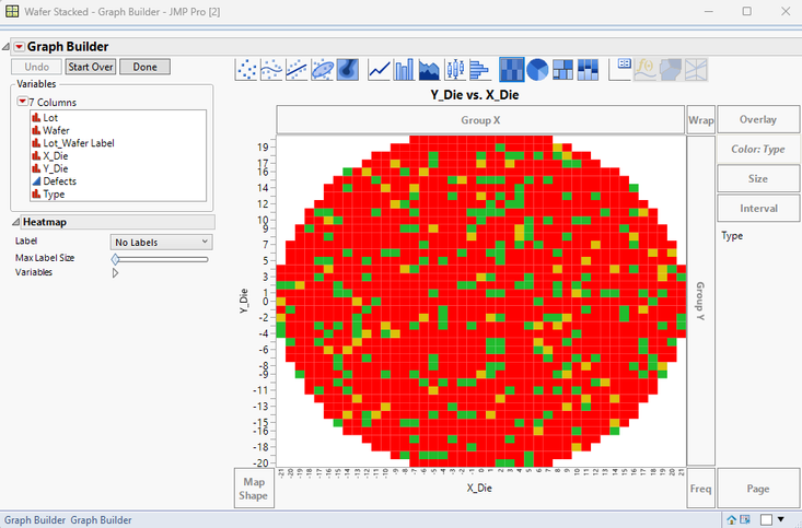

txnelson
Re: Creating a wafer map with discrete cell values
It appears that JMP 14 forces the colors to a gradient.  Therefore, I ran the wafermap and then created a custom gradient pattern, where only 3 colors were defined for the gradient.  The code below was generated in JMP 14

txnelson

rhakim23
Level I
Thank you very much! This would be a good workaround until my company upgrades JMP :)
