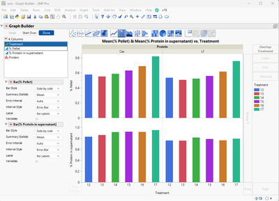

Hello everyone!
Does anyone know how to create individual Y axis for a bar chart that consists of two different panels? I'd like to adjust the scale on the top panel but I haven't been able to do so... I've tried dragging two different variables onto the Y axis. While that works for the axis' scale, it does weird things for my error bars, since it combines the standard deviation of both panels onto one.
Any solution would be appreciated :)
Thanks!

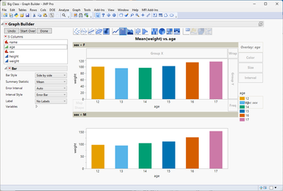

If you don't mind the layout changing, you could use Page instead of Y-Wrap
Otherwise, I think it will require separate columns

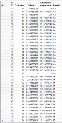

If you lay out your data table differently where your Y axis is not set by a Y Group, but rather you have 2 separate columns for your % Pellet and % protein... and your different protiens are X grouped you will be able to adjust your Y Axis independently
Here is my example table.
