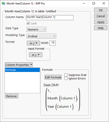

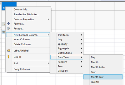

If you have valid date column, you can right click on the column and create new formula column
This will then create you a new column which you can modify as needed
