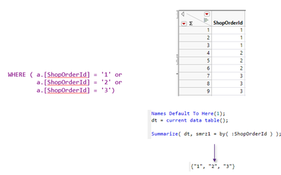

Use summarize to create an list of items and then concat items to build it into string sql can understand.
For example if you can use IN
Names Default To Here(1);
dt = open("$SAMPLE_DATA/Big Class.jmp");
Summarize(dt, uniq = By(:age));
sql_in = "('" || Concat Items(uniq, "', '") || "')"; // "('12', '13', '14', '15', '16', '17')"
-Jarmo

You have to evaluate it inside your string
sql_template = "\[
	SELECT *
	FROM *
	WHERE
		col IN ¤sql_in¤
sql_str = Eval Insert(sql_template, "¤");
show(sql_str);
I use "¤" instead of relying on the default "^" as it might appear from time to time in some regex patterns.

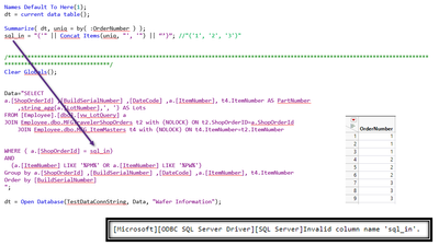

Thanks Jarmo,
I used the script you suggested. It is storing order number in sql_in. But SQL query is not pulling any data.
I confirmed that SQL is working fine when I use WHERE (a.ShopOrderId = '12345') to pull data.
What am I doing wrong.
Thanks in advance
Re: Create string of unique column value for SQL data pull
Somehow script was not attached to my last message.
dt = current data table();
Summarize(dt, uniq = By(:OrderNumber));
sql_in = "('" || Concat Items(uniq, "', '") || "')";//"('1','2','3','4','5')"

Data="\[SELECT
	a.[ShopOrderId] ,[BuildSerialNumber] ,[DateCode] ,a.[ItemNumber], t4.ItemNumber AS PartNumber
    	,string_agg(a.[LotNumber],', ') AS Lots
	FROM [Employee].[dbo].[vw_LotQuery] a
	JOIN Employee.dbo.MFGTravelerShopOrders t2 with (NOLOCK) ON t2.ShopOrderID=a.ShopOrderId
    JOIN Employee.dbo.MFG_ItemMasters t4 with (NOLOCK) ON t4.ItemNumber=t2.ItemNumber
	WHERE
		col IN ¤sql_in¤
		AND
		  (a.[ItemNumber] LIKE '%PM%' OR a.[ItemNumber] LIKE '%PW%')
	Group by a.[ShopOrderId] ,[BuildSerialNumber] ,[DateCode] ,a.[ItemNumber], t4.ItemNumber
	Order by [BuildSerialNumber]
sql_str = Eval Insert(Data, "¤");
show(sql_str);
