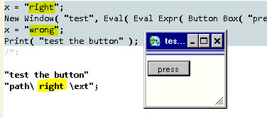

Here's one approach.  Expr( ... ) marks the value you need to cast in stone when the button is created.  Eval Expr( ... ) searches for Expr and evaluates it; the result in this example is the expression Button Box( "press", Show( "path\ right \ext" ) ). Eval( ... ) evaluates the Button Box expression.  All three are needed and work together.
x = "right";
New Window( "test", Eval( Eval Expr( Button Box( "press", (Show( Expr( "path\ " || x || " \ext" ) )) ) ) ) );
x = "wrong";
Print( "test the button" );
x = "right";
x = "wrong";

You Sir are an absolute legend!!! Thank you so much for that it is exactly what i neeeded.
