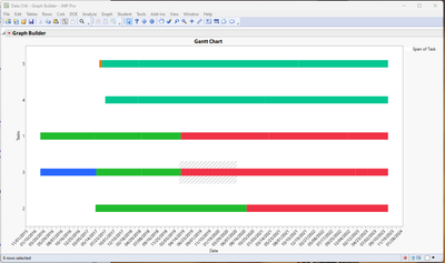

Thank you so much!  Your solution is almost exact to what I was looking for.  I could not fully understand how you manipulated the data to get different color bars for each time period.  Here are 2 questions from your script:
1.  How can I show the legend for each category?  on the top right? - like the values A,B,C,D,E etc in the table?  Is it also possible to show them above or inside each color bar for each unit?
2.  I see white colored rectangular spaces behind the colorred bars.  What are they and can I not show them in the graph?
Appreciate your help to refine this further.  Thanks a lot!
txnelson
Re: Create a timeline horizontal bar chart with varying category over time
JMP does not have a built in chart to produce what you want.  However, it does have the ability to modify default graphs to get what you want.   So, the JSL I provided before, and have added more annotation to, and listed below uses the Graph Builder Platform, to create the general form for the required graph, but then the script adds graphics to it, that provides the desired results, and deletes the original results.  In my first listing of the script, I just changed the bars produced by the original GB, to be displayed using white.  However, I have changed that to just delete the original bars.  The original bars is what you are seeing in the background of the chart.
Concerning the Legend, it needs to be created.  You need to take on that challenge.  First, you need to study the current script.  Rea
