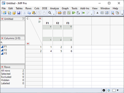

Start data:

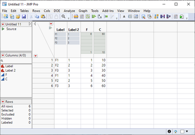

Stacked data with some cleanup (Recode columns to remove F from Label and new C column to perform calculations)

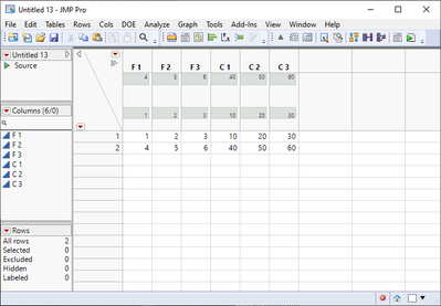

Split final data
