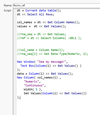

Hi jmp community
I have 19000 col x 88 rows containing data continous data values from biomarker expression.
I want to iscreate a new column for each marker containing a formula substracting the biomarker expression value - reference value.
No need to select any rows as I want all rows from both the biomarker and ref.
So it seems pretty straightforward, but I am struggling just to insert the biomarker data into the new column (I have tested the formula but doesnt work either)
The code doesnt contain any iterations as I just want to see first if it works for one single column first

Hi @BioJmPCoder , can you paste the code using the <JSL> icon in the post buttons?

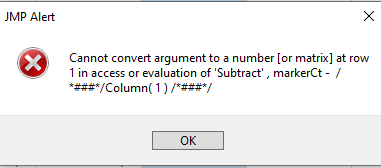

Thanks for the input, I am trying to normalize all data point of column by substracting to to the values in column 1. Here I get the values from Column 3, but I get the error showed below. Maybe I need to vectorize the values and make them not as strings? before the difference can be executed?
dt = Current data table();
col_names = dt << get column names(string, continuous);
markerCount = Column(3);
normCount = markerCount - Column(1);
dt << New Column( "Norm_" || col_names[3],
		numeric,
		continuous,
		format( "Fixed Dec", 3, 2 ),
		set each value( as column(normCount))
		//set each value( as column(Column(3)) - column(Column(1)))

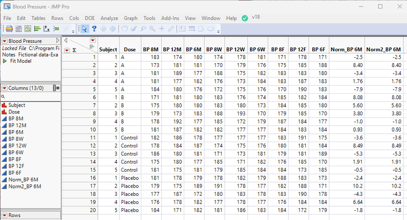

There seems to be some confusion on how to manipulate columns in a data table vs. working with JSL variables.  Below is a script that uses 2 methods to create a subtraction of the values in column "BP 6M" with the values in column "BP 8M"
Method 1 creates column Norm_BP 6M, and method 2 creates column Norm2_BP 6M
I have annotated the JSL in hopes to help you understand what the 2 different approaches are doing
	numeric,
	continuous,
	Format( "Fixed Dec", 3, 2 ),
	set each value( As Column( col_Names[3] ) - As Column( col_Names[1] ) )

dt << New Column( "Norm2_" || col_names[3],
	numeric,
	continuous,
// Pull the data from the 2 columns in the data table
matCola = column( col_Names[1]) << get values;
matColb = column( col_Names[3]) << get values;
// Subtract the values in matCola from matColb
matResults = matColb - matCola;
// Put the results into the new column
column( "Norm2_" || col_names[3] ) << set values( matResults);
Jim
