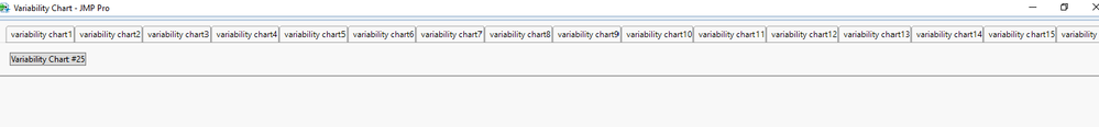

Hi, all
May I know is there any function that can make if I have 25 tabs in one user interface, then for example every 5 tabs, it will automatic go down another row(meant here 1-5 in first row, then 6-10 in second row and etc), which can prevent the user to scroll horizontally to the right.
I have search the scripting index for the tab list box, but I can't find any suitable the function.
Can anyone give me some hints?
Thanks.
For example script below:
nTabs = 25;
VariabilityWindow = New Window("Variability Chart",tb = Tab Box() );
For( i = 1, i <= nTabs, i++,
	tb << Insert(
        i,
		"variability chart" || Char( i ),
		V List box(
			Button Box( "Variability Chart #" || Char( i ) ),

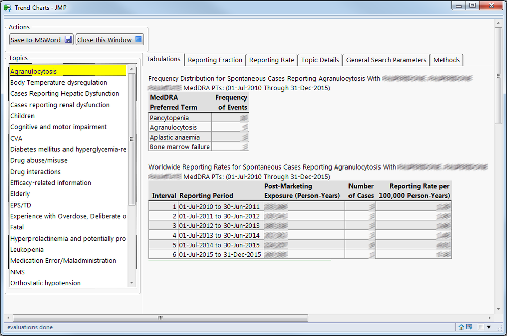

Maybe think about changing your interface a bit.
I had a similar situation where initially the number of tabs was small (5-10).  Then I encountered situations where there were going to be 35 tabs!  I changed the interface completely to the following:
I put a listbox on the left side with the names of the tabs in it, now called "topics".  Since it is a listbox there was no problem handling 35 topic names.  When the user clicks on a topic the display to the right gets updated with information/displays for that topic.  Incidentally there was so much information to display for a given topic that I split that into separate tabs, but there were a constant number of them (6).  Here's a sample:
