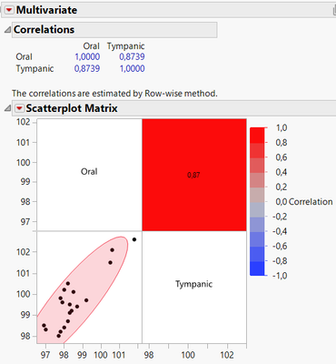

Hi @kasias,
R² (coefficient of determination) and R (correlation coefficient) are two different things, evaluating different aspects with different equations.
Using the same Therm.jmp dataset as in the example or here : Example of Comparing Matched Pairs, I can find the same correlation coefficient than in the Matched Pairs analysis platform between the two responses with the Multivariate platform, estimating correlations in a row-wise manner :
So the correlation coefficient used in the Matched Pairs analysis is the Pearson Product-Moment Correlation.

Hi @bbenny7,
The parameter "Correlation" represents the calculated correlation between pairs of measurements (in the screenshot, between the two responses "Tympanic" and "Oral" measured on the same subjects, hence the "Matched Pairs" analysis).
You'll find your answer in the following JMP Help section : Statistical Details for the Correlation of Responses

I also have the same question this week. That link is helpful for visual but doesn't give an equation for the matched pair correlation number.
It also seems to imply that the matched pairs correlation number should be related to the Rsq of a linear regression but when I compare the two on my data, they are very different. For example a dataset with poor Rsq (1 data point not following linear trend) still has a strong matched pair correlation #.
Anywhere suggestions where to look for the details on the equation? Thanks!!

Hi @kasias,

Re: Correlation in Matched Pairs Platform
oh great! that's what I was looking for. Thank you!!
