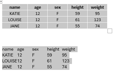

When trying to copy data from a data table and pasting into an email, JMP will not respect the columns on pasting vs if you copy and paste from excel it will respect the columns.  So my work around is to save the data table to an excel table, copy and paste it into the email, then close the excel file.  Beyond annoying.  I'm hoping that I am missing something obvious as a better way to perform this task.
Here is an example of excel (top) vs JMP(bottom) when pasting data from Big Class into an email
The more that the values in the columns are of different lengths, the worse this gets.
Thanks for any ideas!

Re: Copying and pasting data from the data table to email
Hey @Ben_BarrIngh !
thanks for the reply, I tried your method and I am still getting messed up data when I try pasting, here is an example with trying the method you mentioned:
JMP on the top, excel on the bottom
I'm wondering if I need to make a script that saves the copied data to excel so I can press one button, have the excel data pop up, and then I can copy it more easily and close the excel sheet.  Still pretty annoying but a little more streamlined.  Not sure if there is something I could put in as a wish list.

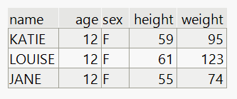

Not sure if TableBox could be used to "bypass" JMP table
Names Default To Here(1);
rep = Current Data Table() << get as report;
rep = rep[TableBox(1)] << Copy Table;
This could of course be improved to take into account selected rows and columns
-Jarmo
