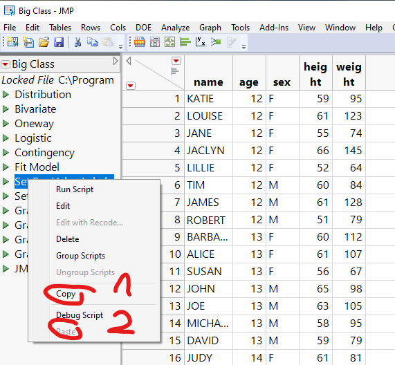

Often I just want to duplicate a table script (e.g. in table Big class) see screenshot.
Via context menu in table property area I first do Copy and in a second step I do Paste.
This in some case works (and an new script with the same Name and attached "2" is generated).
Most times it does not work, why?
What is the easiest way to duplicate a script?
My only Workaround is to copy the Content and the Name into a new script. It's possible, but many more Manual work.

Re: Copy/Paste a table property (e.g. script) does not work
on my System (JMP Pro 15.0 or JMO 15.1) at Win10 it does not work.
To be more precise:
I open Big Class
Right click on "Distribution" -> Copy
Right click --> Paste --> Nothing changes!!!
I would have expected a script named "Distribution 2" to appear.
Copy works (because I can do paste into a new script window),
Paste probably also works (overwriting the current script with the same Name, so Nothing changes in the view).
But generating a copy of an existing script with a new Name does not work (i.e. replicating by adding " 2" to the Name doesn't work)
And the Miracle is, that it works sometimes.
Usually it works on the update script, and then a new one is created: "Update From Database 2"
and it works on table variables like "SQL", there "SQL 2" is generated.
Why doesn't it work Always?
For example see table generated by below script. For "SQL" it works, for "Oneway" it doesn't.
