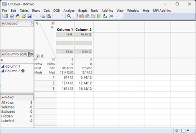

Re: Convert number to time
Here is format pattern option, note that if your time is in 12-hour format, it will need some changes
InFormat(Right("0" || Char(:Column 1), 6), "Format Pattern", "<hh><:?><mm><:?><ss>")
-Jarmo
New Table( "Time",
	Add Rows( 2 ),
	New Column( "Time as Coded Number",
		Numeric,
		"Continuous",
		Format( "Best", 12 ),
		Set Values( [61412, 142954] )
	New Column( "Time",
		Numeric,
		"Continuous",
		Format( "h:m:s", 12, 0 ),
		Input Format( "h:m:s", 0 ),
		Formula(
			t1 = If( :Time as Coded Number < 100000,
				"0",
			) || Char( :Time as Coded Number );
			In Hours( Num( Left( t1, 2 ) ) )
			+In Minutes( Num( Substr( t1, 3, 2 ) ) ) + Num( Right( t1, 2 ) );
You need a formula (or script) to convert the original 5 or 6 digits (assuming hh:mm:ss coding for a 24-hour clock) to the number of seconds (JMP's time base) and change the column format.
