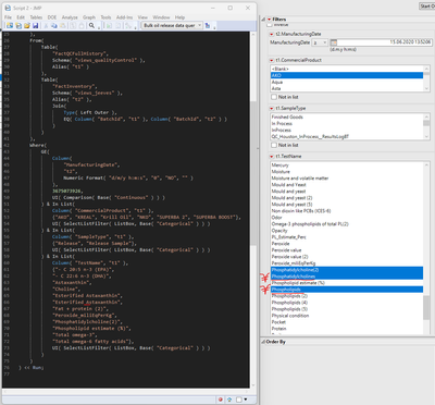

As with JMP 17 I am finally able to run the Query Builder without it constantly crashing (there was an unresolved ticket with JMP Tech Support), I really started using it to relatively great effect. However, it is not making some of the selections I tell it to do. This means I have to copy the script and modify it manually to reflect my selections.
See the below screenshot for example:
  • "Esterified Astaxanthin" was added twice with capital A in astaxanthin, although there should be "Esterified Astaxanthin" and "Esterified astaxanthin"
  • "Phospholipid estimate (%)" is part of the query although I haven't selected it
  • "Phosphatidylcholines" is completely missing, as are "Phospholipids"
There are actually quite a few additional mismatches between what is selected in the Query Builder and what is copied to the script. I am wondering, have other users experienced the same?

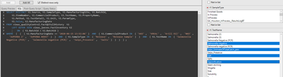

Hi and thank you for looking at this. I am connecting to Google BigQuery via Simba ODBC. Below, I am adding a few screenshots from inside the Query Builder.
nr. 1:  see how the selection panel to the right correctly displays "Esterified Astaxanthin" and "Esterified astaxanthin" and how this is inaccurately transcribed to the SQL. No other selections were made for this example.
nr. 2: this was interesting. In this screenshot you can see that when I select "Phosphatidylcholines", "Phosphatidylcholines(2)" is written to the SQL. You can see by the red indices I have added that the selection above the one I have made is written to the SQL. You can see this even better in screenshot nr. 3 below.

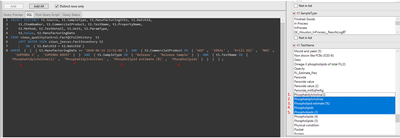

nr. 3: here, I have deliberately only selected every other parameter. These are now not written to SQL. In screenshot nr. 4 I have tested whether the occurrence of "Esterified Astaxanthin" and "Esterified astaxanthin" are the root cause.

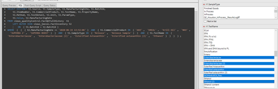

nr. 4: "Esterified Astaxanthin" and "Esterified astaxanthin" appear to be the root cause.
