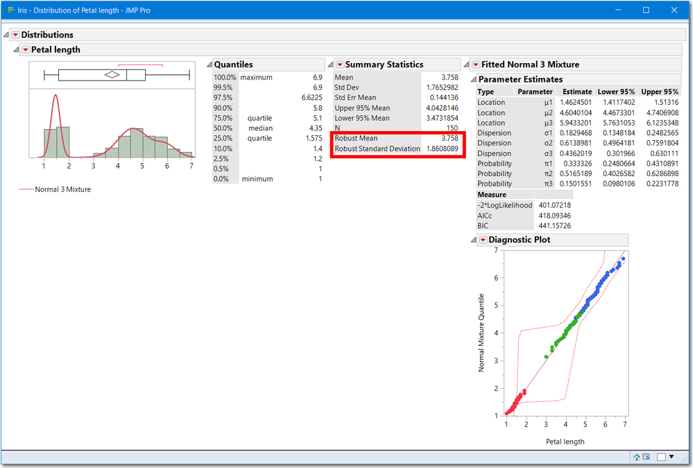

Below is an example of  using one variable Petal length from the Iris sample data table. I chose to fit a Normal Mixture with 3 groups since I know  there are 3 species. I chose this beacuse it displays the centers (means), confidence intervals for the mean, dispersion and what portion of the data is estimated to belong to each group. Having  the mean and dispersion you could compute a zscore/probability of belonging to each group.
Names Default to Here(1);
dt = Open("$Sample_data/Iris.jmp");
dist = dt << Distribution(
	Continuous Distribution(
		Column( :Petal length ),
		Horizontal Layout( 1 ),
		Vertical( 0 ),
		Fit Distribution(
			Normal Mixtures(
				Diagnostic Plot( Median Reference Line( 0 ) ),
				Clusters( 3 )
		Customize Summary Statistics(
			Robust Mean( 1 ),
			Robust Std Dev( 1 ),
			Set Alpha Level( 0.05 )
Otherwise, you need to clarify your request.

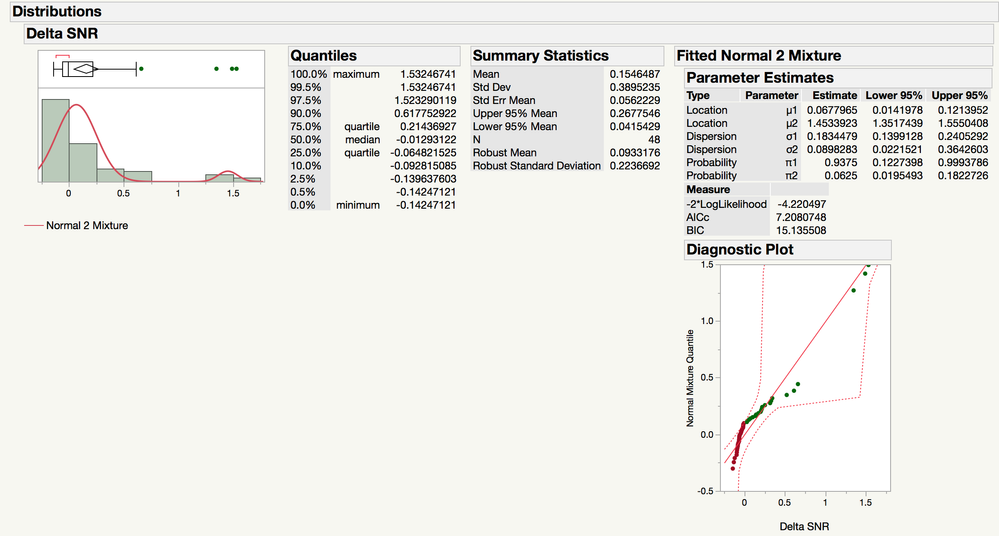

Thank you so much for the help and recommendations. I used two normal fixture fit and have attached the result. I like to know what is the confidence interval for exactly value of zero (where green and read color are seperated in diagnostic plot). Thanks again.2mixture.png

Looking at your data, you have some extremes that are affecting the fit and the dispersion estimates. Where do the red an green come from? Do you know there are two mixtures in your data? And if yes, are you looking at missclassification at the cutpoint?
From experience, it is dangerous to interpret data without knowing the data context and what is the real question.
  • I still do not understand your request "confidence interval for excatly value of zero."
  • The fitted normal does not fit. If you have a column representing Red and Green, say it is called GRP. Use  Fit Y by X for Y (:Delta SNR) and X(:GRP) and create a normal quantile plot.
  • Delta SNR suggests a difference. If there two variables used in the computation of ths Delta, multivariate methods like k cluster methods.
In other words, I will advise due to lack of information. Sorry.
