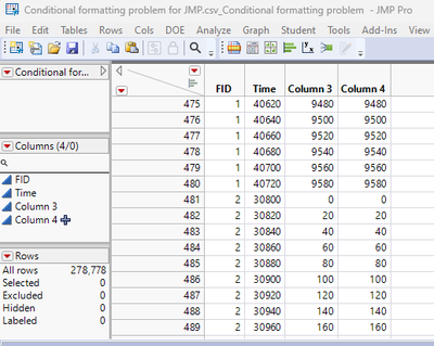

I have 1.7mil rows of data that are linked with common identifiers. I can format smaller portions of it it in Excel but with the size of the file (greater than the excel limit) and the need to reproduce similar data sets I would like to figure out how to code the data in JMP.
Column A (FID) is a series of fish identification numbers (1,2,3…) with a variable number of reads which populate Column B (Time). Every read for Column B is an interval of 20 seconds.
Column B start at various reads >28000 as a result of the previous time stamp they were associated with. I want the first read of each FID to start at 0 then increase by 20 for every row associated with that FID. So C2 will equal 0 sec., C3 will be 20 sec., C4 will be 40 sec., and so on until we get to FID =2 then it will reset and start counting it at 0, 20, 40, 60.

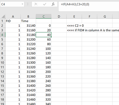

In Excel, as seen below, I can set the first row of a new column to "0" then apply the formula: =IF(A4=A3,C3+20,0)
When I attempt to apply similar logic to the conditional formula in JMP I cannot figure out how to have it recognize the value of each row and adjust. Likely a fundamental difference between data handling packages like Excel and statistical packages like JMP, but JMP is my preferred software for analysis and the size of the data files requires it. I am using Version 16, JMP.
