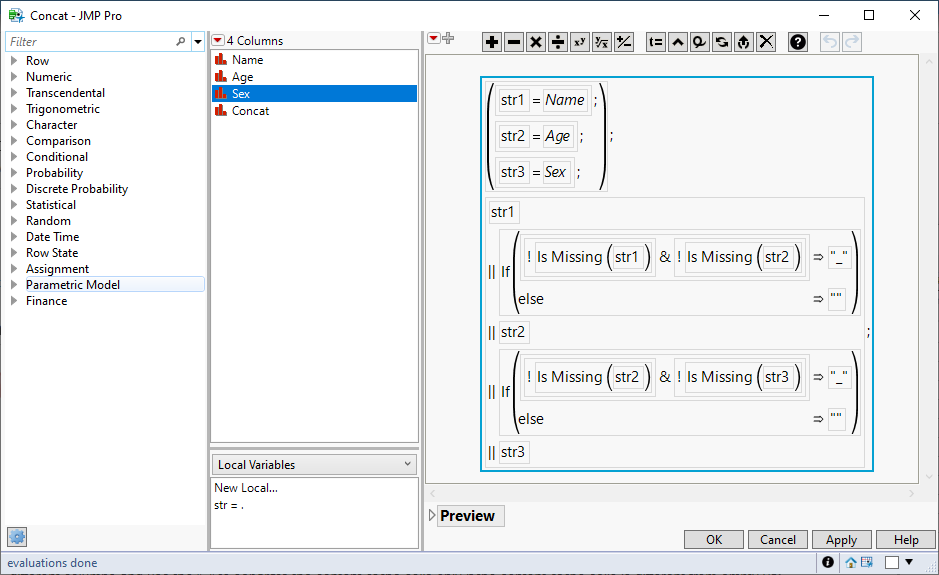

Re: Concatenate columns with empty cells
You should be able to use a simple function in a new column Concat:
