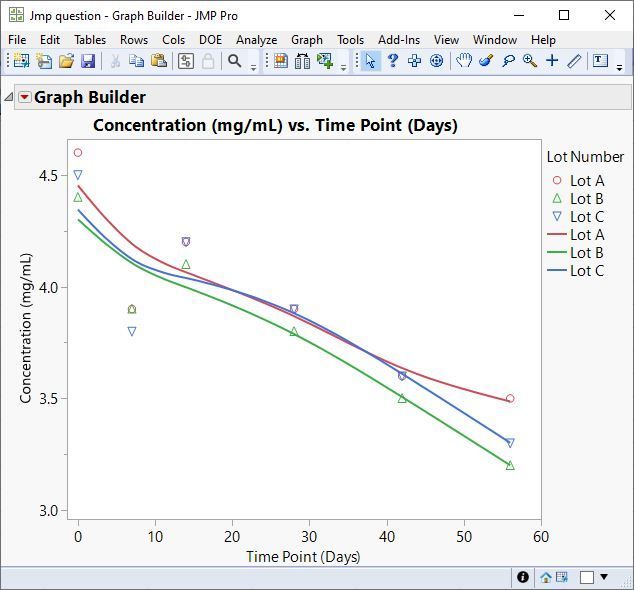

This data appears to be from a stability study. Here is a plot of the data you provided:
It exhibits a linear degradation path. There seems to be a data anomaly on day 7 for all lots. A logistic model is not suitable for this case.

Re: Comparing the slope of a exponential 3P model.
Yes, you are correct that it is a stability curve. Do you have a recommendation I can work on so that I can perform a parallelism test?
Please see the chapter for the Degradation platform for general background information and orientation. There is a section near the end about stability analysis.
