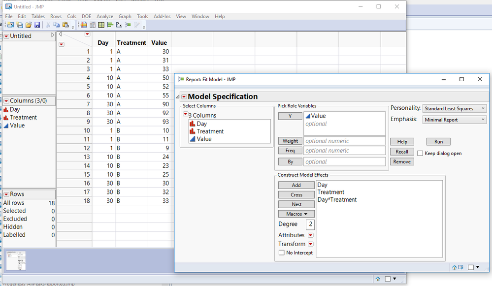

Hi Acbart,
the "Fit Y by X" plattform only works for 2 variables. As you are analysing 3 variables you will have to work with "Fit Model".

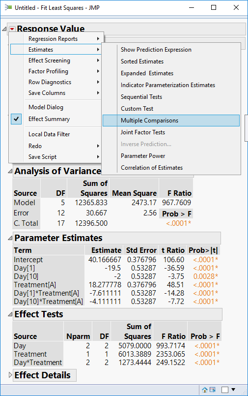

Now in the report chose the main hotspot (red triangle on the top left) and go to "Estimates" => Multiple Comparisons
The dialog provides multiple methods of comparing means. You will find more information about these methods in the help: https://www.jmp.com/support/help/14/multiple-comparisons.shtml
