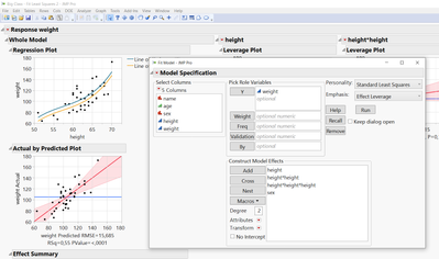

This may be basic but I'm struggling to find a way around this in JMP. Pardon me if this has been discussed previously on this forum. I essentially want to statistically compare regression lines. However, these are polynomial curves. All the options I have tried in JMP fits a linear curve by default which is not a good fit for the data.
Briefly, I want to perform a hypothesis test to assess whether there are differences among the categories within my dataset. I am able to do this using the 'Fit Model' dialog. But I am unable to the regression as 3rd order polynomials. Hence, JMP automatically applies a linear fit.
Is there a way to tell JMP to perform polynomial fitting in the "Fit Model" dialog.
Your help is appreciated.

You can build this model as well in fit model platform (Macros --> Polynomial to degree ...),
using sex in By-role you can fit separate regression models, save them as formula and compare them as you need.

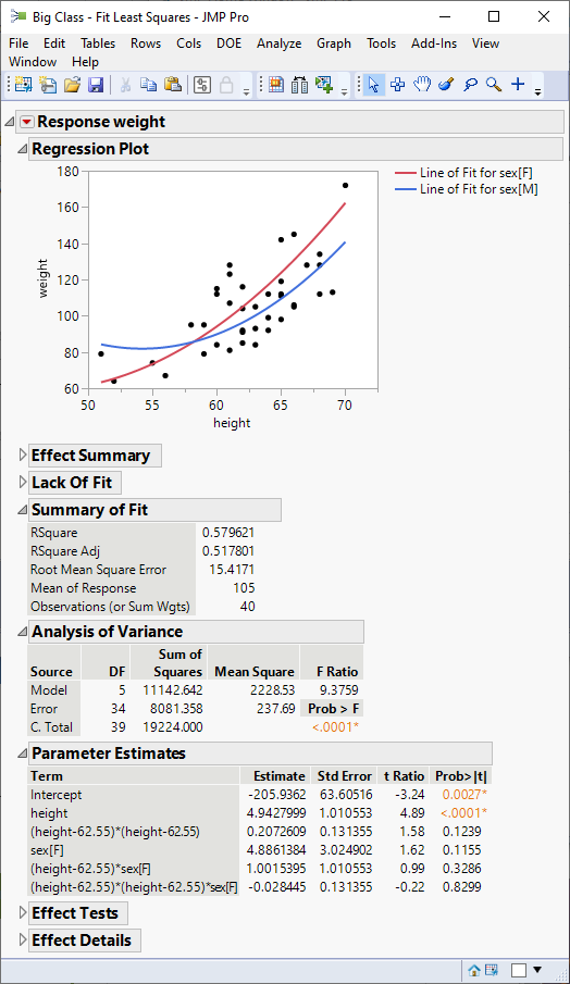

I think @Georg helped but didn't go far enough. That is to say, you need to add interaction terms for all the X terms. Here is the same example, but with an interaction term for all the :height terms:
So this case concludes that there is no need for a unique intercept, first-order, or second-order term across sexes.
Note that these effect tests are appropriate for a difference in the parameter estimates across groups. They are not appropriate for equivalence.

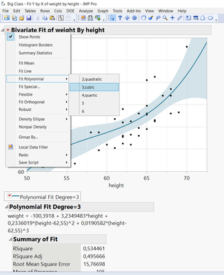

In platform fit y by x you can perform polynomial regression, and you can also show confidence region,
maybe this helps?
