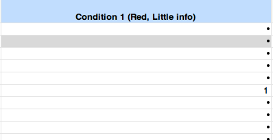

I have a data set where I would like to merge four columns  into one column, so that
the values of the four columns are displayed in one column. However, I have no clue how to do that.
I have four conditions, which respondents have been exposed to depending on the day of the month
they are born. If a respondent has been exposed to Condition 1 it shows a 1 and the same for
conditions 2,3, and 4. How can I easily recode the 1's of each column into names and then merge the
four columns into one column?

How can I easily recode the 1's of each column into names and then merge the four columns into one column?
You've asked a two-part question.
1) How do I recode the 1's into names? For this you can use Recode.
2) How do I merge four columns into one column? For this you need a Formula, using the Concat function or operator.
-Jeff

Combining columns is not hard - you can use a column formula.  However I'm having difficulty understanding exactly what you want to do.  Can you provide a little more data, and what you want the final output to look like?

If you want to re-code the 1's into names, you would make new columns that have the re-coded values for yourself, then simply merge all the data together using cat, ||, etc.. There are many ways to concatenate in sas..
So for example, see the (untested) code below.
Data answer(drop=Variable1new--Variable4New);
set have;
if Variable1=1 then Variable1New="YOUR TEXT";
if Variable2=1 then Variable2New="YOUR TEXT";
if Variable3=1 then Variable3New="YOUR TEXT";
if Variable4=1 then Variable4New="YOUR TEXT";
FinalVariable=Catx(',', of Variable1New--Variable4New);
run;
Look into the catx function since I don't have it memorized.
Is this what you are looking for?
