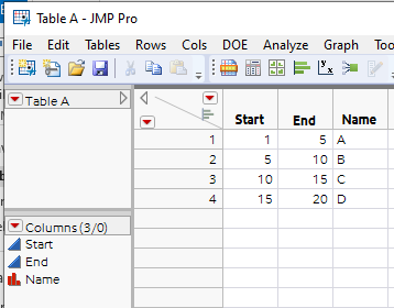

I'm trying to create a new master table by combining data from two tables (or more). As an example, I'm trying to combine Table A & Table B below into Table A-B as the result:
Basically both table A & B have similar column in "start" & "end" but different range for each row. What I'm trying to do is to combine the segments from starting distance 1 to 20 from both table and combine them into table A-B.
Any idea on how to do this through either scripting or the Tables functions ?
