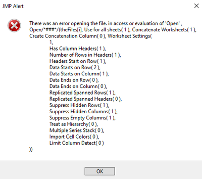

aaronjiang
Level I
Re: Combine data from different workbooks in stack format
I tried this script, and got the following error. Not sure what happened, wondering if you could help. Thanks.
txnelson
It looks like the definition for the "theFiles" list is incorrect or non existant.  What is the value of theFiles and what is the value of the variable i?
