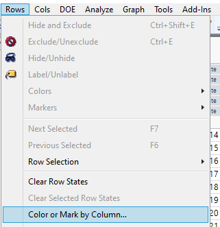

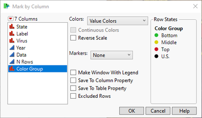

The answer might depend a bit on what you are using the table (and colors) for. There are pure scripting options or you can do this interactively: When you have Value Colors in one of your columns select that column and go to Rows/Color or Mark by Column
then press OK from the menu.
This will set this these colors as row states

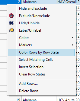

Right click on those rows and select color by row state

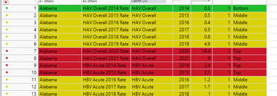

now you have all rows with those colors.
Then select all columns you don't want to have that color, right click on one of the selected cells and make the color white
You will end up with specific colors as row states on rows though with this method and color on your cells (you use white to overwrite the row state color)

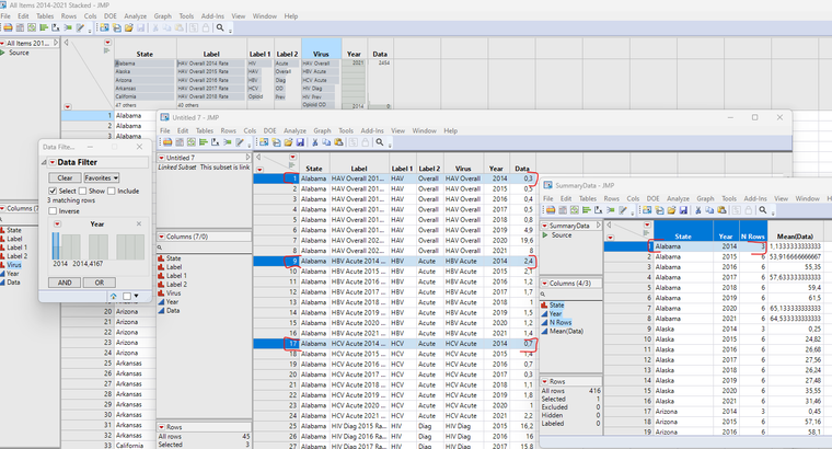

This helps a lot. But the first part of your script, where it generates the summary data. What does N rows mean? I need to know which virus each one is.
Ressel
Level VII
Re: Color code Top 5
The N Rows column shows you how many columns exist for one group in your main table. In the screenshot below, the summary table tells you that there are 3 rows for Alabama in 2014, and so on. This does mix the different viruses in column Mean(Data).
